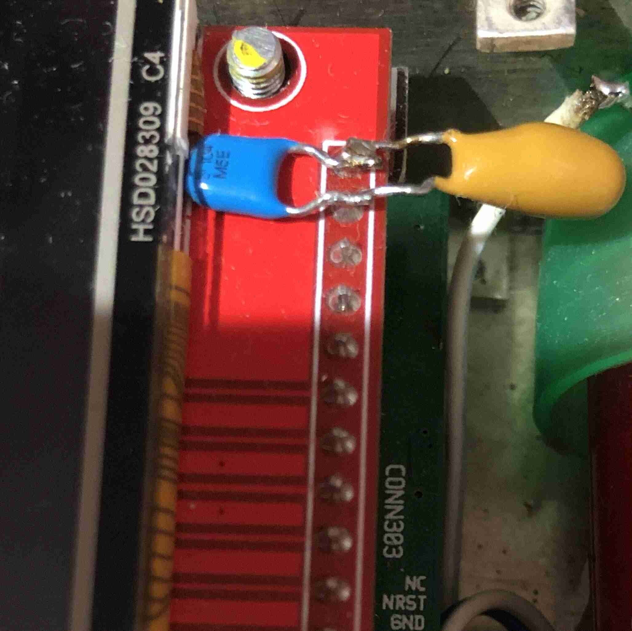

add newest fw from dislord for the plus4 ... and maybe some caps on the
power rails (to further lower the noise) and you will have a superb device

What is the benefit of the caps on the power rail? Are there any instructions on how to do that?

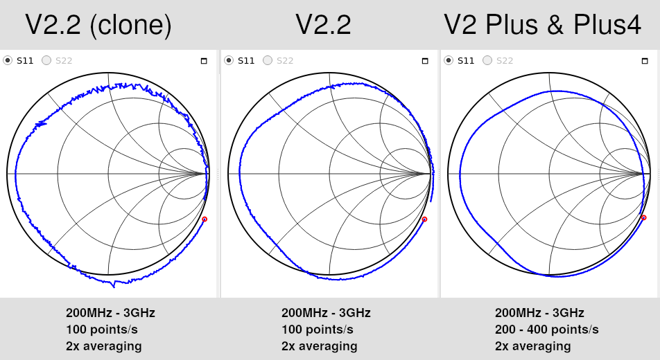

Genuine or Clone ???
Read the entire content of the OFFICIAL WEBSITE written by the creator >>>
https://nanorfe.com/nanovna-v2.html
[https://nanorfe.com/images/nanovna-v2-main2.jpg1zB]<https://nanorfe.com/nanovna-v2.html>
NanoVNA V2 Official Site<https://nanorfe.com/nanovna-v2.html>
NanoVNA V2 (S-A-A-2) is a vector network analyzer (VNA) capable of measuring antennas, filters, duplexers, and amplifiers. 4GHz operation without using harmonics - new from-scratch design by HCXQS/NanoRFE; Low temperature drift (V2 Plus4) - automatic internal calibration corrects for drift errors; High dynamic range: 90dB (V2 Plus4), achieves similar results as professional instruments; can ...
nanorfe.com
Specifically - read the sections >>>
"Beware of underperforming clones"
"FAQ"
Do Not Purchase from other than from Official Stores.
I purchased mine from Tindie. The ordering process was efficient and delivery was about three weeks.
The Official NanoVNA V2 Plus4 is an excellent product and works as described.
Read this document - thoroughly - before purchasing >>>

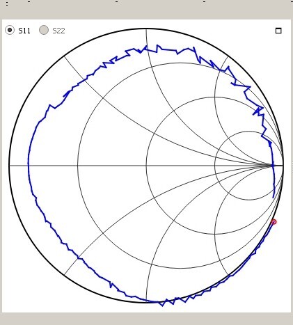

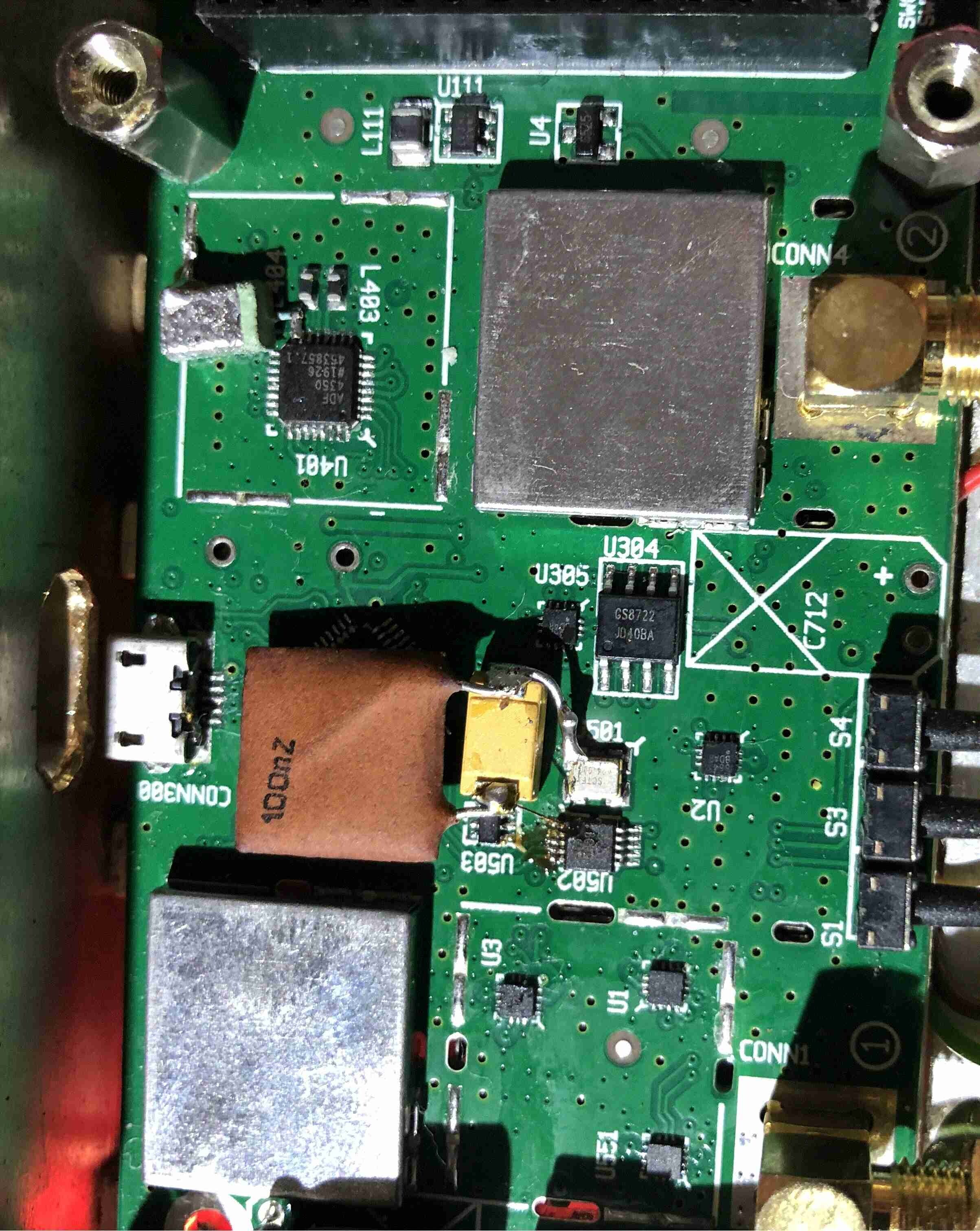

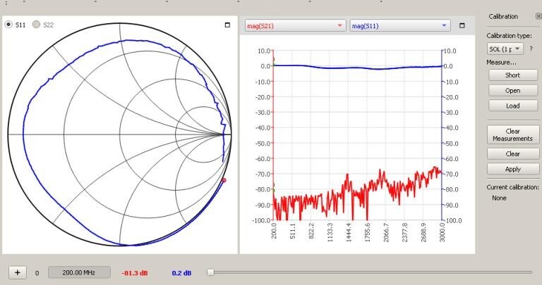

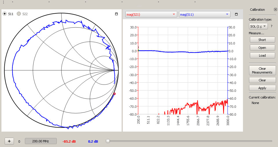

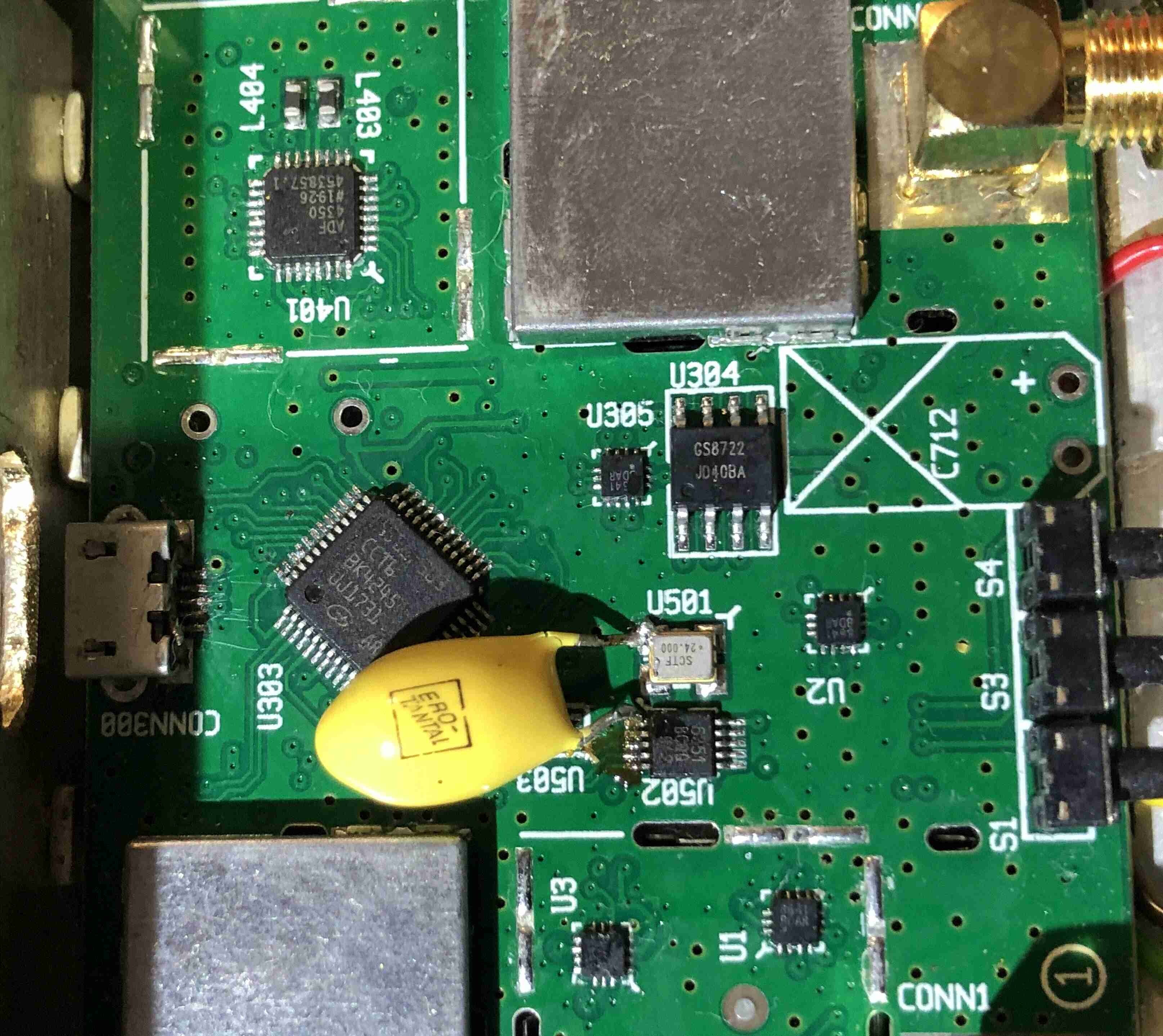

Siegfried Jackstien 2022/05/29 23:13
maybe those pictures help a bit?!?
in fact a few caps on all rails but main thing is dirt from the display!!!
i made a few tests (including disconnect and reconnect display!!!)
picture names tell what i did ....
the v2plus4 has better filttering as v2 or saa2n ... so improvement can
be nothng ... or the holy grail (depending what unit you have)
ps added caps lowers noise so you have exacter and finer sweeps
