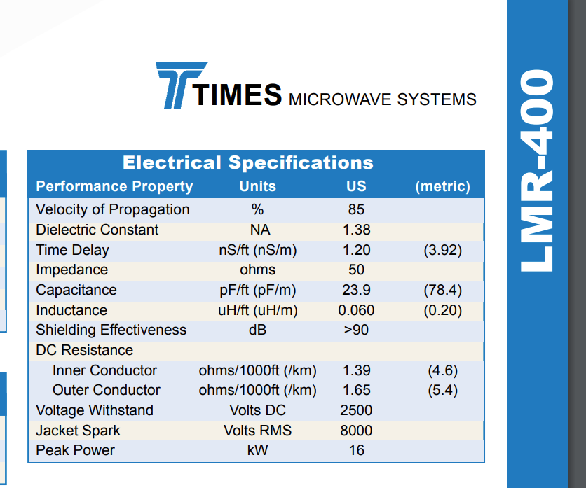

LMR 400 [is] for low power operation.
Not at all. LMR-400 datasheet snip:
73 de AI6KG
