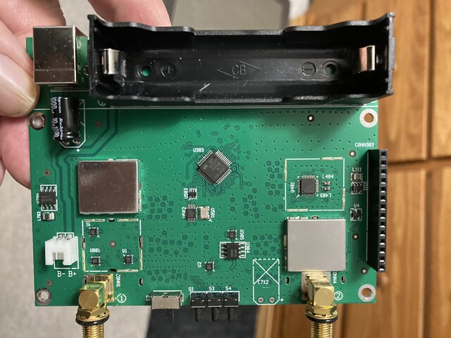

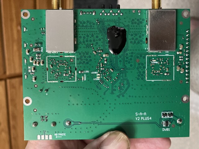

I have a Nanovna V2Plus4 I purchased from the (old and no longer exists) NanoRFE store on Aliexpress in April 2021.
I have since updated the firmware so cannot tell that way what the hardware version is.

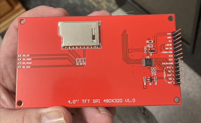

Opening the unit, it has a V1.0 display board, and I can find NO indication on the main PCB which HW version it is.
>From reading this page it is not an unofficial hardware variant https://nanorfe.com/nanovna-versions.html as it looks just like the picture of the V2Plus4 at the top of the page.
Can someone tell my from these pictures what HW version it is?  I see no 2.2, 2.3 etc etc on the PCB.
PT 2025/02/21 15:33
@nanov2support, any info you can give me on this what appears to me to be a 'real' V2Plus4?
nanov2support 2025/02/21 20:00
Hi, this is an original V2 Plus4 (V2.4). It is supported by the latest firmware on the NanoRFE website.
