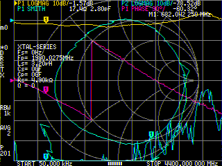

Vladimir Lebedev 2022/08/03 02:04
Hello John!
The original FW from ojisankoubou has no screen capture option (in program NanoVNA-APP)
This FW for 2.8" device was compiled 20201202 (not from me).
In attach:
- binary from 20201202
- screen capture from NanoVNA-APP 1.1.206
