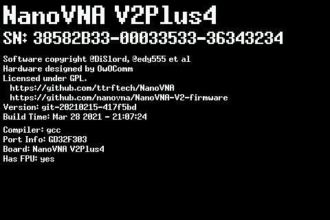

DiSlord 2021/04/05 08:58
Go to version screen and at bottom see text
Has FPU: yes/no
Vladimir Lebedev 2021/04/05 08:59
On Mon, Apr 5, 2021 at 11:49 PM, n2msqrp wrote:
> How can I tell if my NanoVNA v2.2 has a FPU?
> Hello Mike!
It's easy --> CONFIG--->VERSION
Has FPU: yes OR Has FPU:no

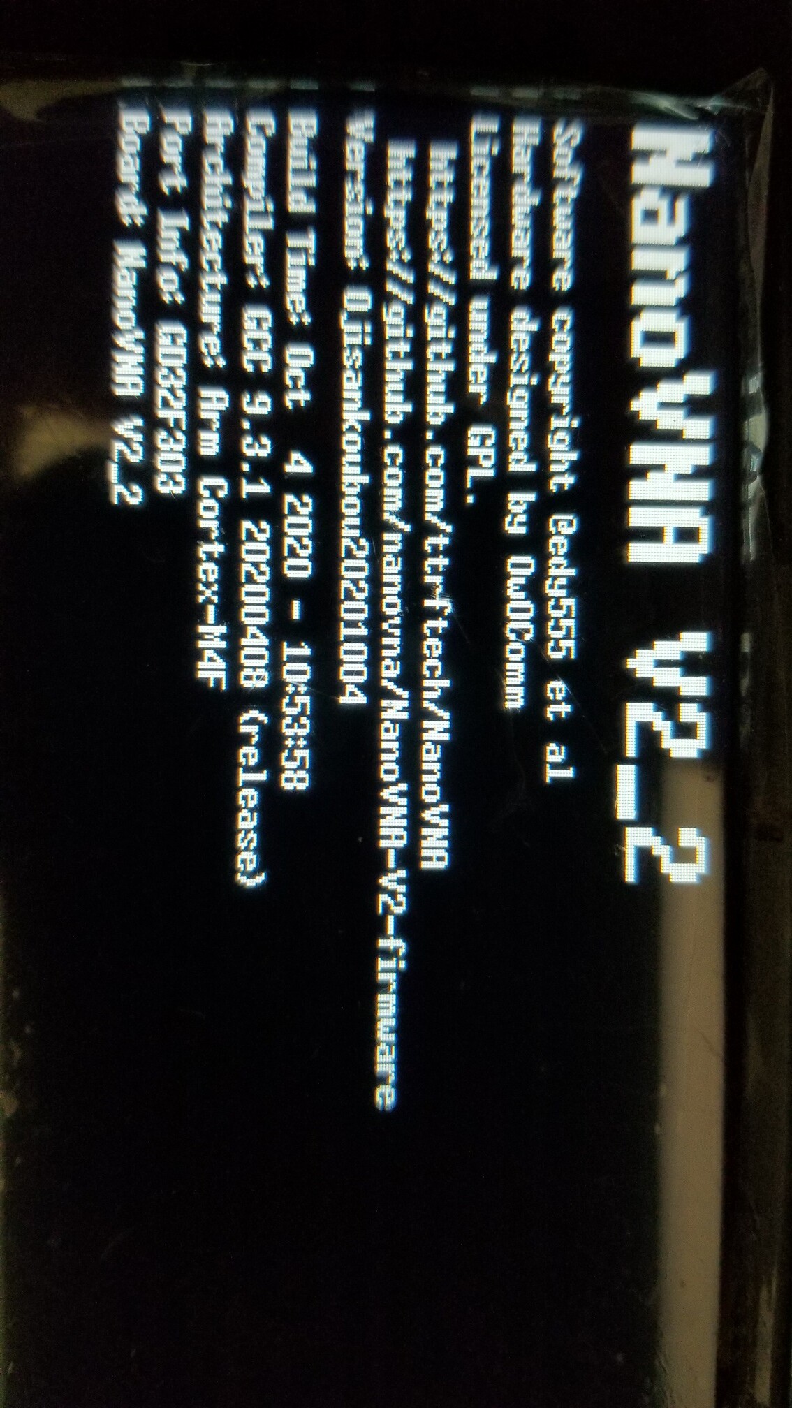

n2msqrp 2021/04/05 12:10
My V2.2 SAA-2N does not show a FPU. Shall I use use firmware V2 480x320 grid noFPU ?
Mike N2MS

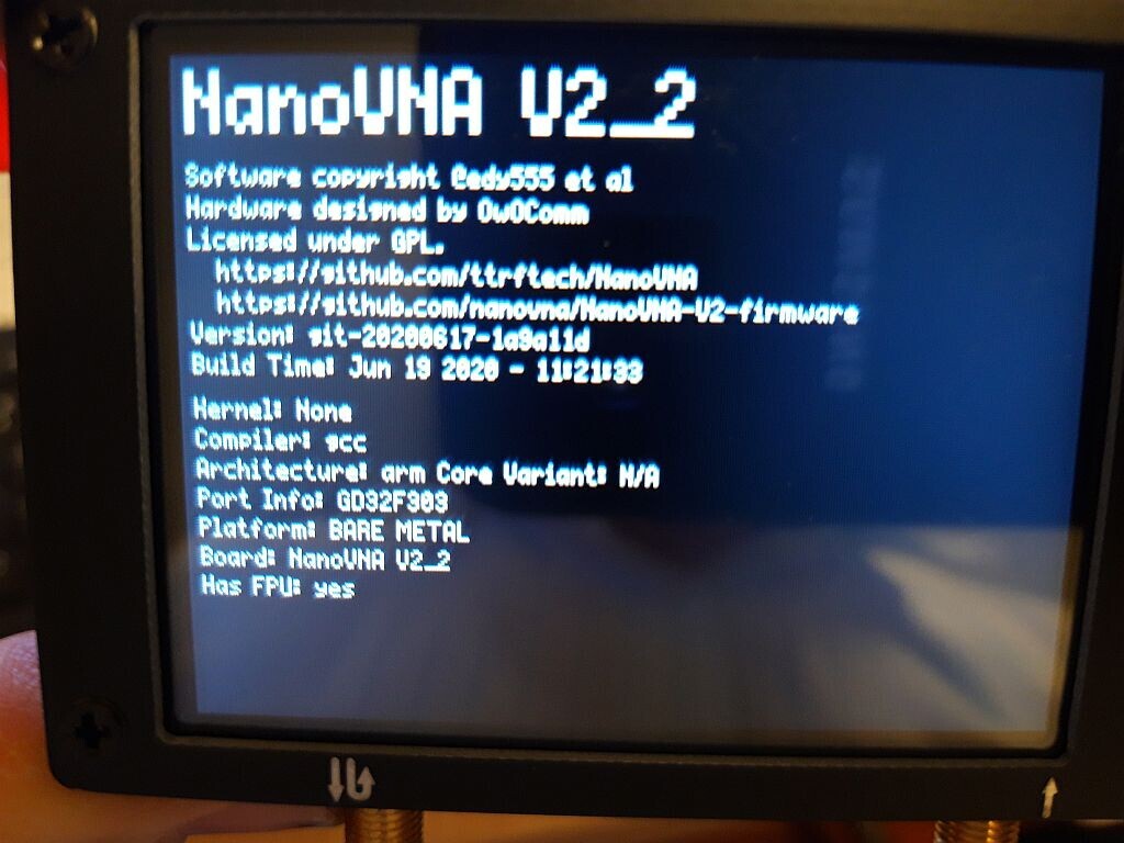

n2msqrp 2021/04/05 12:39
I loaded the V2 480x320 grid noFPU firmware unto my SAA-2N over Ojisankoubou firmware. The version now shows it has a FRU so I loaded V2 480x320 grip firmware.
I noticed you changed the DPU key to BOOTLOAD,
Thanks for the new firmware. I will be experimenting with this code.
Mike N2MS
Siegfried Jackstien 2021/04/05 17:00
read
on your screenshot it says has fpu : yes

n2msqrp 2021/04/05 14:00
The Ojisankoubou firmware I had on the SAA-2N did not show the FPU state.
Mike N2MS
