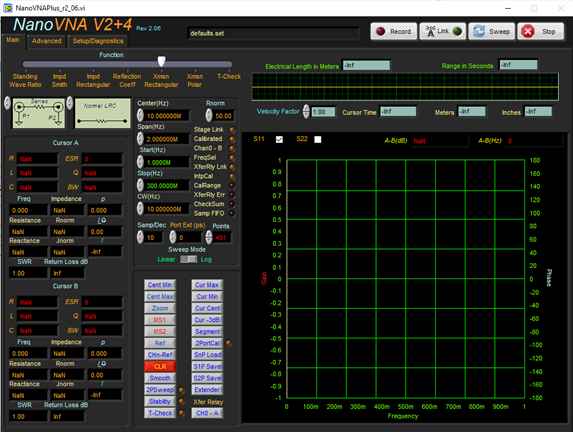

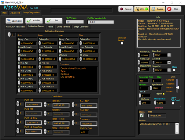

Joe, thanks for the new software release. You did a great job.
I tested Rev 2.06 with a NanoVNA V2_2.
In the Xmsn Rectangular diagram, now there is S11 & S22 written instead of Gain & Phase.
Rev 2.08 was tested with a NanoVNA-F.
Guido
