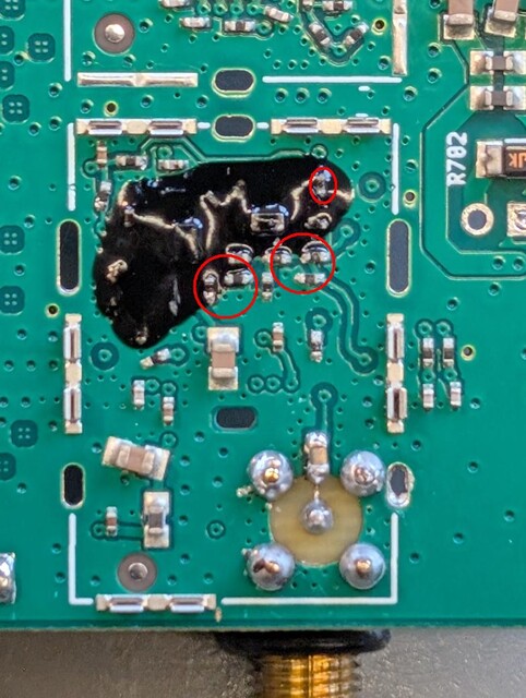

Thank you for getting back. Check resistor values and change them if needed. Also the dielectric constant could have changed in the burned area of the PCB and may also cause insertion loss in the RF paths in this area of the PCB. Glad to help. God bless you, John
