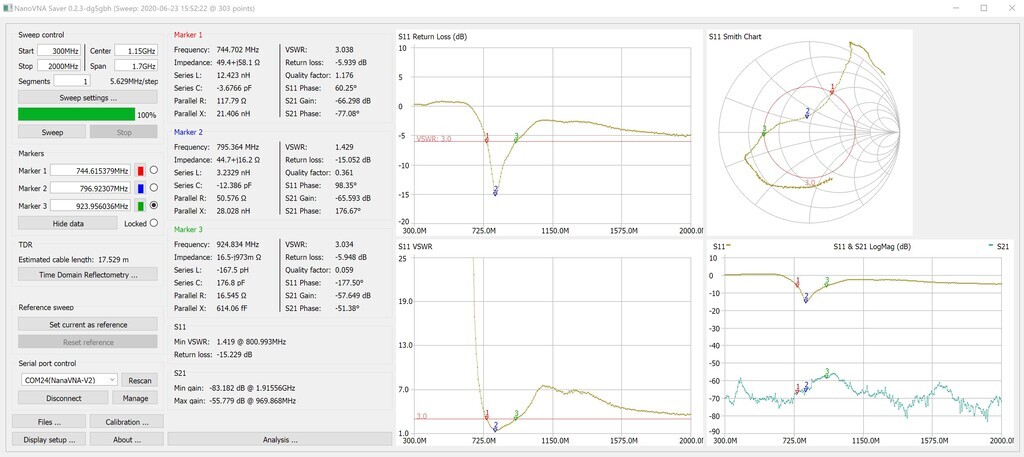

MarkZ 2020/06/23 12:57
As a matter of usage, I only run the v2 using nanovna-saver from a computer. This gives me lots of high resolution plots that I can screen-capture or save an S1P or S2P file. So, here's a screen-shot I've got lying around, and a screen-shot of an excel comparison of a bunch of data... At my age the 'look at screen' thing doesn't work very well for the tiny screen and even changing sweep range is an agony, so... that's me.
-Mark
