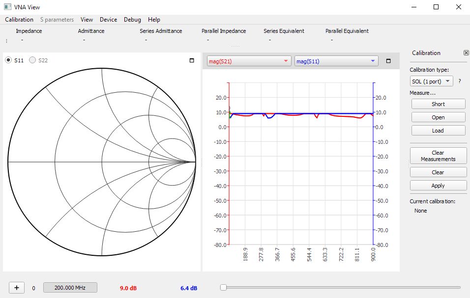

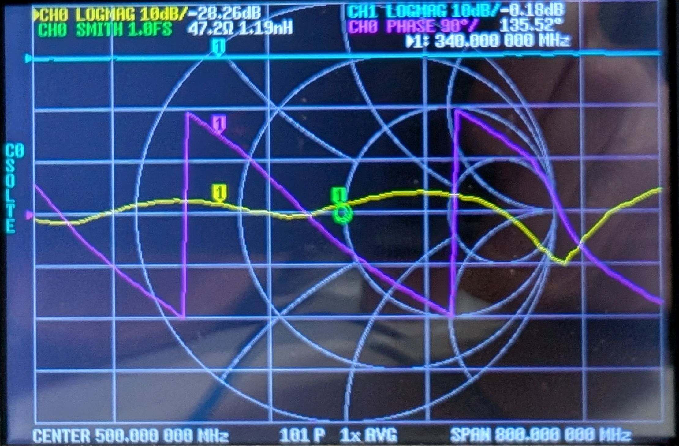

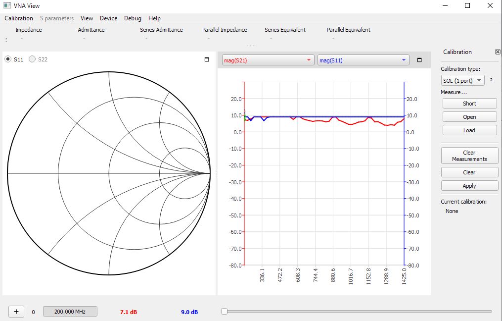

Jos F.M. VanderList 2025/03/04 02:16
Good morning,
I am attaching three files. One is a picture of the screen of the NanoVNA Plus 4, the second is a screenshot of the VNAView and the third is a text file containing USB data.
The nanoVNA Plus4 (which was bought from Tindie, so no clone!) was calibrated for 100 MHz to 900 MHz.
The data in the text file was captured with pynanovna (from Github). I am worried about the 0j values for s11. I sometimes also see values like -2.2-j.
cocopuppy asked if I tried another cable and yes I did. It makes no difference.

nanov2support 2025/03/07 08:04
Hi, if the traces on the device are correct, then it can't be a hardware issue, as USB communication is error checked and any errors will cause USB to disconnect.
I have asked engineering and it is most likely that another program on your computer is using the serial port at the same time, can you check for any modem programs (such as ModemManager on Linux)?

Jos F.M. VanderList 2025/03/07 10:54
Good evening,
I tried an older version of nanoVNA-QT and the result is identical.
I also tried another PC (without anything else connected), also with identical results.
As you can see from the results in the data file that I sent it is mainly the s11 data that are corrupt.
I also have an older nanoVNA V2.2 (SAA2-V2). If I connect that VNA to nanoVNA-QT the results are normal.
So, I agree that the RF hardware is OK, since the traces on the built-in screen are OK.
Also the calculation of the traces is OK, but something is wrong with how the results are sent via USB.
