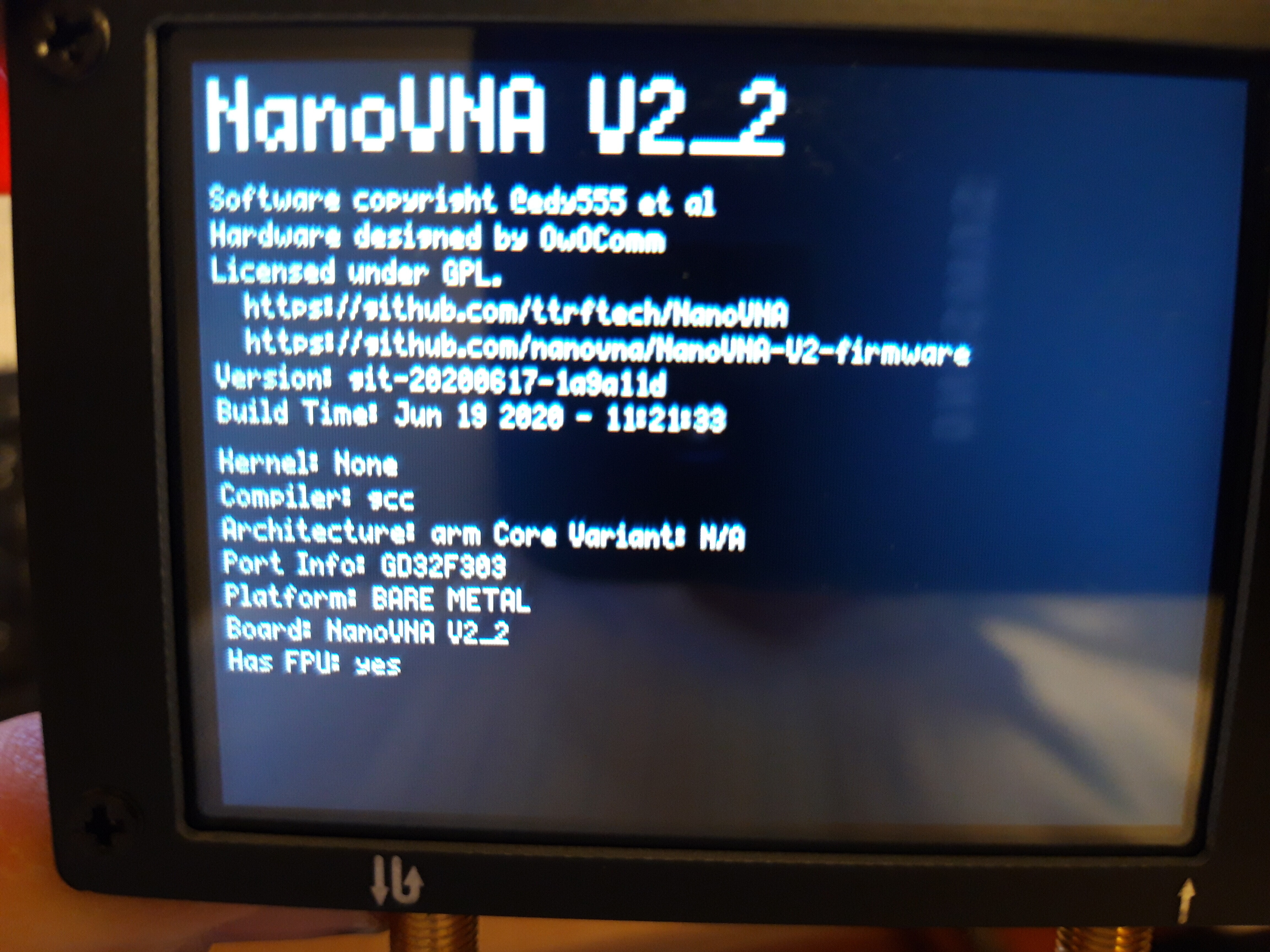

I flashed on my nanoVNA with 3.2" display the following firmware version: nanovna-v2-20201122-v2_3_2.bin . It ends by v2_3_2.bin, I guess because it is for the 3.2" display.
Online there are newer firmware versions, the latest is 20210425, but they ends by v2plus.bin or v2plus4.bin. Can I use them for my 3.2" device? If not, can somebody add to the repository the 3.2" version, please? The repository URL is: https://nanorfe.com/downloads/20210425

Vladimir Lebedev 2021/05/03 04:48
Dear Simone,
i tried to help you, but you don't believe me and you ask the same question in the other forum.
1. I told you how to check if your V2 has FPU or not. Please see attached screenshot ( CONFIG--->VERSION)
2. I have sent you the current and the best firmware with the accompanying text from the programmer DiSlord.
I have tested ALL FW since the first release 20200328. 20201122 is not good, bugs!
3. I explained that the FW for V2 with 3.2 inch display is the same as for 2.8 inch - these displays have the same chipset and resolution 320x240 pixels.
It's OK?

simone 2021/05/03 15:19
Dear Vladimir,
Thank you very much for helping me, I appreciate it a lot.
I asked the same question in the V2 forum in the hope somebody adds the new
releases also for 3.2 inch display. Otherwise the people with a device like
mine will miss all the great firmware upgrades.
I am sorry if you thought I do not believe you, I trust you and I thank you
for your very appreciated support.
Have a nice day,
Simone
