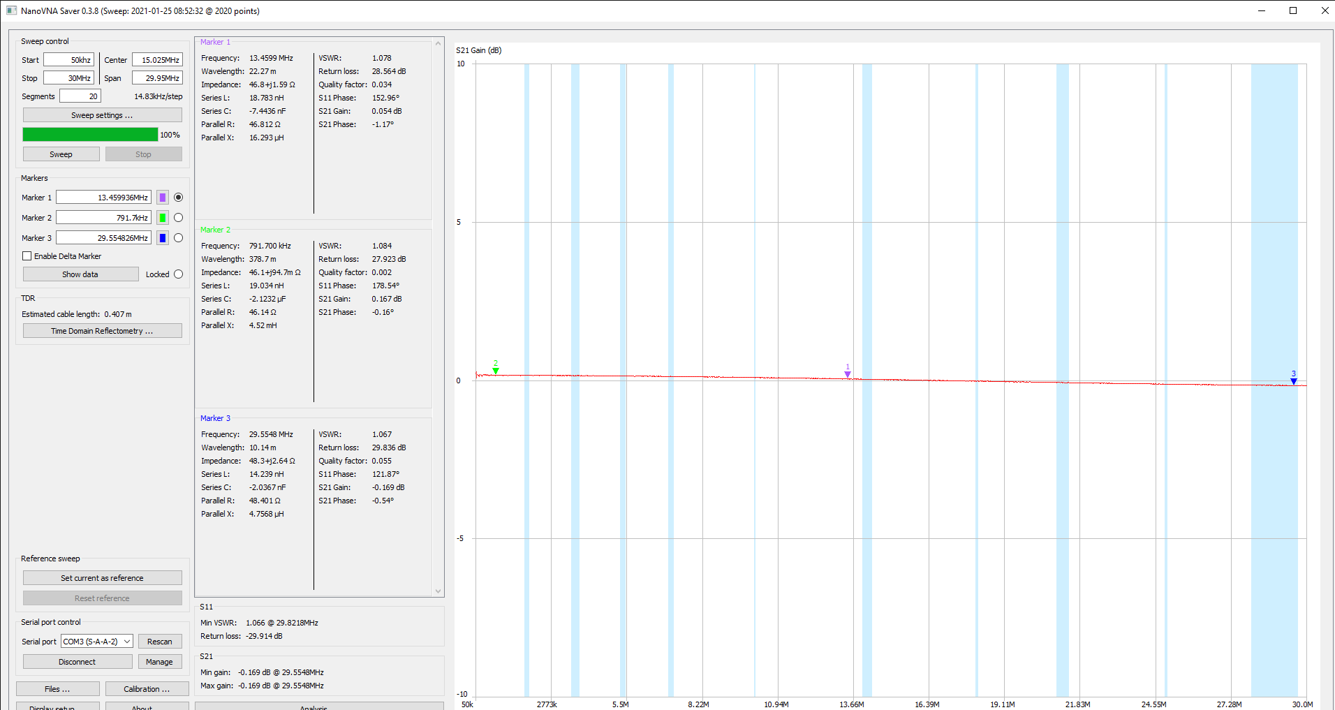

Tom Paratore 2021/01/25 14:01
I am using an Official VNA2plus 4 and firmware 20201124-experimental.
Calibration does not report accurate S21 measurements after calibrations.
see screen shot below.
It reports S21 min and max as being on same frequency and both negative, when clearly from the chart there is actually a positive(?) S21 after calibration?
How do you get "gain" after a 2-port calibration with a through connected? this should be zero/-flat.
[cid:dc57062b-d915-4d40-a9f4-bb6cd1a3588b]

It's a known bug in nanovna-saver. Can you see if thru calibration works
